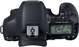

I would trade the mode dial for something useful. :)
