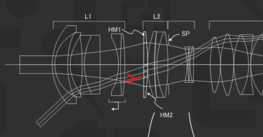

How would the light know only bounce one round-trip?
It's rather complicated to understand, a least for me. The HM element (HM = Holographic Mirror) acts like a catadioptric lens. The centre of the front allows transmission but directs light to peripheral areas of the back surface that reflect it back to reflective regions of the front surface that then reflect it to transmissive regions of the back surface. So the light is folded as in the patent for one round trip. It requires incredible accuracy of engineering at the nanometer level to work.
  • Wow
So for example if you look the lowest path of those 3 lines starting from down drawn on the patent, it bounces once and then goes through the second time.
But if you had another photon coming on the red arrow I drew (poorly) so it enters the same trajectory as the bounced photon, would they both pass the same spot on the back of the lens or would the red arrow photon make bounce while the other one goes through.
Photons don't have memory so if they hit the same spot, they should both behave the same. But then the red arrow path wouldn't make the bounce. So there's something strange here, maybe they left out something critical.
You have to use the wave nature of light to account for the interference/diffraction/phase shift etc and not think about bouncing photons.
Ok, can you explain how that helps it bounce only once while another photon/wave on same trajectory wouldn't if it had already completed one bounce?
Fyi I have masters in physics so complex explanation is ok. I just can't figure out how that could work the way they have it in the picture, other than that they haven't told something critical about the design and how it operates.

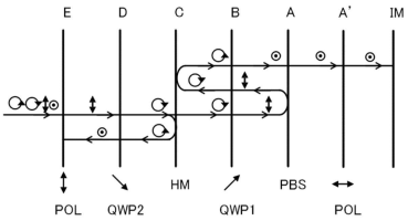

It's not that Canon didn't tell us, it's that Richard didn't pass along the full explanation. He hints at it, though, right at the start: "I had previously discussed these as quarter-wave optical designs...," in reference to the quarter wave plates (QWP) that convert linearly polarized light to circularly polarized light and back.
Details are in the patent, and the light manipulation you're missing is polarization, more than once in the optical path and both linear (POL) and circular (QWP2, QWP1), plus selective reflection/transmission.
By the above operation, only the light transmitted through the half mirror C, reflected by the polarization selective transmission reflection element PBS, reflected by the half mirror C, and transmitted through the polarization selective transmission reflection element PBS is guided to the imaging plane IM.
