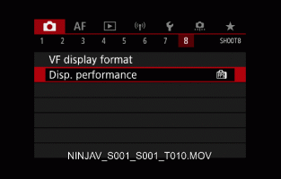

Tried it with my EF 100 F2 using [
Low-speed continuous shooting
] Low-speed continuous shooting
Setup:
R5
Sony Cfexpress card
EF 100 F2.0
Atomos Ninja V - To record display
Shutter Speed 1/400
Aperture F2.8
ISO 1600
Electronic first curtain - I did try Mech and electronic and saw no difference
I am just not seeing this additional black out
UPDATE:
The Atomos does not capture the blackout seen when shooting [
] Low-speed continuous shooting or [
High-speed continuous shooting
] High-speed continuous shooting. Once I removed that I was easily able to see what @Viggo is talking about.
