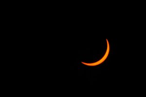

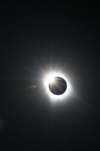

I've attached two images form a solar eclipse seen in the South Pacific in July 2010. My disclaimer, this was with a marginal tripod. Shot on my old 50D on while on the deck of a rolling ship. So you can extrapolate, I was using a 70-200 f/4 lens and then cropped.
The first is at near complete and the second is the "signet ring" shot when it is safe to remove the filter for a a bit.
