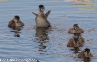

Also DOF causes sharpness problems. I have seen multiple cases where someone lets the camera choose the AF point (they like to choose the closest point) and the part of the image that they were interested in is far enough back that it appears to be out of focus...
For example, take a 600mm lens shot at F8 (typical for Tamron and Sigma 150-600's), and a subject 10 meters away..... the DOF is a surprisingly small 8 centimeters. The following image was shot under those conditions and cropped to show the point. The AF point was centered on the second duckling and the one behind with the wings out is embarrassingly fuzzy...... The one in front is also out of focus.
The camera nailed the shot. It did exactly what I told it to do. I told it to do the wrong thing :(

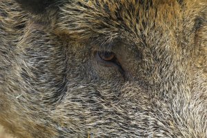

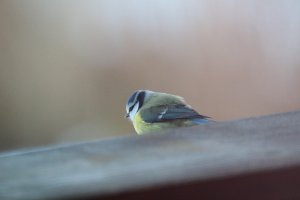

Today I went out testing in a little wildlife parc. Weather was cloudy - so again no low iso, high shutter speeds - but "normal conditions" for a semi-pro canon camera to get sharp pics.
Here are two more, a tomtit and a boar. Distances ca. 3m.
Tomtit: 400mm, f5.6, sandbag, 1/350, is (=ideal), but iso 6400. noise is ok, but sharpness not necessarily good.
Boar: 400mm, f8, sandbag, is, iso 320 (=ideal), time 1/20. that´s ok because of sandbag, is and none moving animal. Sharpness of the eye (focus point) imho bad.
Any comments appreciated.
400mm, f/5.6, 3 m distance...DoF = ~1 cm.
The bird looks as sharp as one could expect at ISO 6400, although the plane of focus is slightly in front of the eye. Looks like the area of sharpest focus for the boar shot is behind the eye, although it's still not sharp. At 1/20 s, I'd expect subject motion blur even in an animal that appears still.
I'm not saying there's not a problem, but I don't think your testing so far has been conclusive.

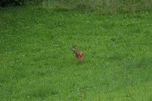

This one about a deer (ca 150m+ away) is not convincing me:
Iso 400, f8, 1/250, 560mm (1.4Ex. III), sturdy tripod, remote release, liveview focus (10x)

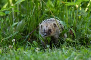

picturefan said:
And out of this pack is another one, best shooting conditions (and a bit of summer feeling when sun comes out) :)
Iso 320, f6.7, 1/250, 300mm, IS, sandbag, liveview-focus, focus on the eyes, distance ca. 30m
Softness comes out at magnifying...
Nope, the image is as sharp as you can expect with your technique (what sharpening technique sare you using in post?) and it shows no signs of equipment issues, same as the boar above shot at 1/20 sec.
privatebydesign said:
It is out of the cam, no sharpening or post so far.

Here I applied some sharpening/saturation (this time not in LR, only in a nice`n´easy freeware called irfan):

For myself, I need any comments on the posted deer. Shooting technique there seems close to optimal to me, but the deer is so-so...
