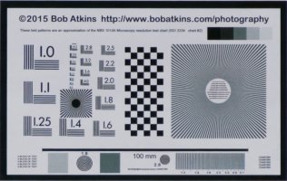

@ AlanF: my testing with the chart you linked to me led to following result:
@400mm, f5.6, 1/4000, iso100, tripod, remote release, liveview. No post. Upper one ca. 1/3 of a letter size. Distance 20m. (Remark: results with af differed from shot to shot. the pic shown is one of the sharpest).
How do you rate sharpness?

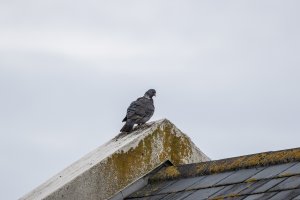

Don't know if the attached helps. A humble Pigeon taken at a distance of approx 35 metres on a cloudy dark and windy day. Canon 7dii with 100-400ii at 400mm. ISO 400 and shutter speed 500th sec. Mounted on solid tripod in AV servo continuous mode. Plenty of mirror slap up.
Two images the first no crop the second significant crop. Whilst not the best of images does show what the camera can produce at distance albeit not a huge distance.

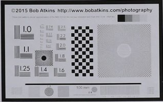

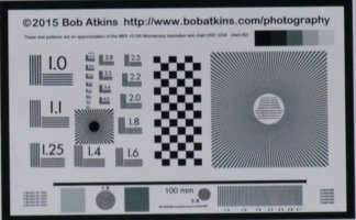

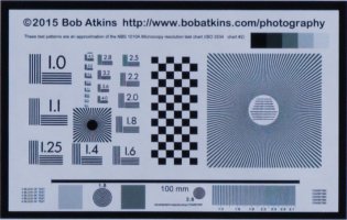

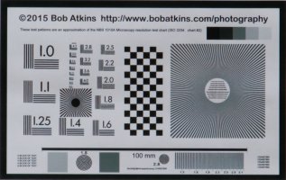

Here is your chart, followed by mine at iso 640, hand held, centre spot AF. Mine have absolutely no sharpening being just converted from RAW by DxO with PRIME noise reduction. Yours have quite a bit of sharpening in camera as you can see from the halos around the lines. Yours are also 14% bigger, possibly you printed larger, which should give you 14% more apparent resolution from the chart.
In order: yours, my 7DII + 100-400 II at 400mm; 5DS R + 100-400 II at 400mm; 5DS R + Sigma150-600mm C at 390mm; 5DS R + 300mm f/2.8 II + 1.4xTC at 420mm; 5DS R + 150-600mm at 600mm.
The target has got wet and dried out for some of them. The winners in order 600mm, 420mm, 390mm.
ps
The numbers on the chart have units of line pairs per mm: e.g 2.8 = 2.8 lp/mm. At a distance of 20m with a 400mm lens and a sensor with 4.14 micron pixels (as on 7DII or 5DS), 1 lp/mm would cover just under 5 pixels. So the, maximum possible resolution would be just under 2.5 lp/mm, if each black line and each white line fell exactly on a pixel. The Sigma at 390mm is getting close to 2.2. At 600mm, the max poss resolution is about 3.6 lp/mm and the Sigma is reaching 2.8, without sharpening.

For amusement, the Sigma at 840mm with the 1.4xTC and f/9 (it still AFs). You get an extra 15% of resolution, hardly worth it, but the quality is good.
I checked again using these charts whether IS lowers IQ. IS actually increased the resolution of my 100-400mm II on the the 5DS R. The 150-600mm set at the standard OS (Sigma's IS) has lower resolution but "Dynamic" IS retains IQ.
