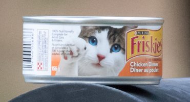

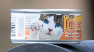

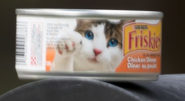

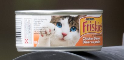

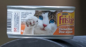

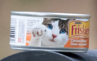

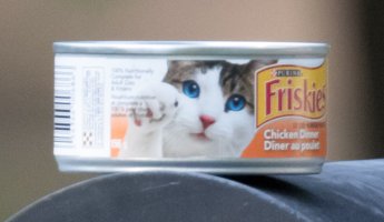

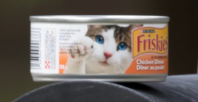

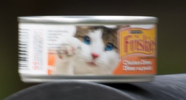

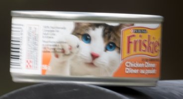

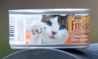

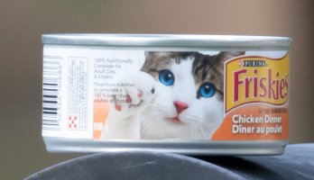

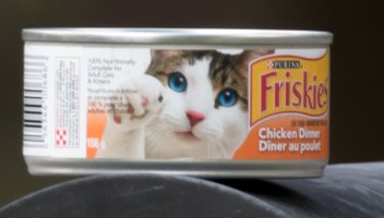

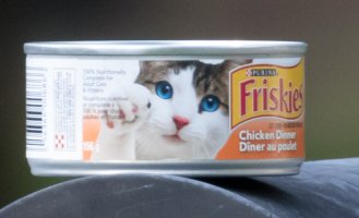

At the level of sharpness that you are after, a well calibrated camera and multiple images is the way to go. AF is not an exact process and the lens will not focus exactly the same each time, so this is where a statistical approach like Focal comes in. Trust me, it will do a much better job of calibrating your lenses than trial/error or Dot-tune.
overcast day, a sequence of different shutter speeds and ISO, all handheld with IS turned on. The first part of the file name is the shutter speed and the second part is the ISO. The target was 20 meters (60 feet) away.

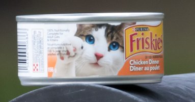

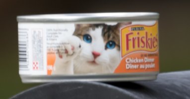

As above, but the camera resting against the car roof.... notice how they are sharper than the free-held images..... stability is your friend!

Don Haines said:
And now resting against the roof with IS turned off. Note how they are sharper than with IS turned on.
There was a fourth set, which I am not going to post because they are pathetic, with IS turned off and freeheld. With my steadiness (or lack thereof) and 600mm, it wasn't a good idea....
EXPERIMENT!
See what works for you! Go with what works for you! Just because one person says "X works best for me" it does not follow that "X" will work best for you. EXPERIMENT!

Don Haines said:
Don Haines said:
EXPERIMENT!
and never underestimate the value of post-processing.....
