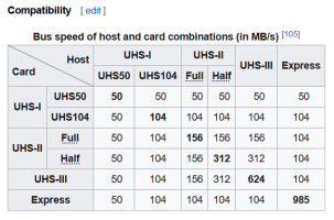

SD slot is backwards compatible for the new SDexpress bus, the fastest card media data transmission rate at this time and in the near future. Research SDexpress. Most new laptops and computers will come with what appears as an SD slot, but has the new SDexpress bus.
SD Express will be externally physically backward compatible with other SD card formats but not speed wise (pin layout). If you put a USH-ii card (or UHS-iii card if they were available) in a SD Express slot, the max speed is UHS-i speed.
I have a brand new macbook Pro and the SD card slot is UHS-ii so your assertion is still in the medium term future.
Can you point to any available SD Express cards available in the market? There are a couple of announcements but no availability or pricing yet.
Being it's now 2022 one may suspect that this device has an SDexpress bus installed in the SD slot. Most likely will be enabled by update if not already.
Canon could have put a UHS-iii slot in the R5 given the spec was released in 2017 but chose not to (or controllers were not available). Specs are one thing. Commercial reality is completely different. UHS-iii will be bypassed completely in my opinion. SD Express looks interesting but only backward compatible with UHS-i speeds ie UHS-ii cards are slow in a SD Express slot.
The latest Macbook Pro is not quite on the level of a gaming console and it's slot does not support the latest and fastest SD standards. It tops out at a paltry 312MB/s. Your other comment is true with any card and host. Even all CFexpress cards are not compatible with all host. Canon list compatible cards. Canon, Sony, and Nikon are on the SD express consortium. They are well aware of the future trends and manufacturing agreements. Any high speed cards can be used in UHS-I, UHS-II, UHS-III and SD Express host devices. Faster performance levels will only be attained when matching the card to the host device. Check out the new powerfull ASUS studio book and scroll down and see what card slot it comes with.
~300MB/s is the current UHS-ii standard. I am not sure what you are referring to as there are no faster SD card media available. The macbook pro is one of the fastest PCs on the market especially on a per watt basis. It might not have video games released supporting that speed but to say that "gaming consoles" relate to having the fastest SD card slots in them seems strange to mention in a photography forum when no camera supports SD Express cards. Why would gaming consoles need fast SD cards?
Canon is on the SD association board. They are well aware of the future trends and manufacturing agreements. Any high speed cards can be used in UHS-I, UHS-II, UHS-III and SD Express host devices. Faster performance levels will only be attained when matching the card to the host device.
Not quite true. UHS-iii and UHS-ii are backward compatible for all host/card but SD Express is not.

I am not following your point here. Some new PCs have been announced (but not released) using SD Express slots. There is no media and they are not backward compatible with UHS-ii speeds.
I agree that SD Express is the logical solution to match CFe speeds but it will be some time (years?) before it makes sense to use it in camera bodies.
