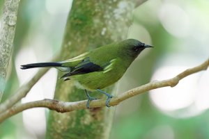

All cameras work best in ideal conditions and low iso, even the 5DIV. Here are two images I have posted previously that show the 5DSR is a capable camera in low light and high iso. This bell bird (in Tiritiri in New Zealand) was hidden under the green canopy with light filtering through. I took a photo from one side with a 5DIV + 400mm DO II at f/4, 1/200s and iso6400, and my wife with a 5DSR, 100-400mm II, f/5.6, 1/200 and iso6400 from the other side (top image). The 5DSR maxed out at 6400 and I pushed hers through +1.56ev in DxO PL after prime noise reduction, so it was effectively at iso19000 (bottom image). Not much to choose between them. Both were hand held. There is a lot of nonsense spouted about the 5DSR by those who have never used them or don't know how to get the best out of them without torturing yourself with tripods etc. The time I prefer the 5DIV is when I need snappier focussing otherwise I go to the 5DSR.bellbird_male_2B4A8000_DxO_CRiso6400.jpgbellbird_male_3Q7A8969DxO_bellbirdmale_CRiso6400+1.56ev.jpg
