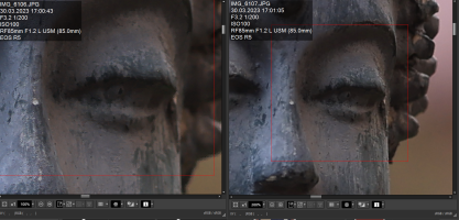

Just playing with this new toy for the last hour.
I do not like this new feature nor I will use it
- You need to use a tripod yes or yes
- If there's any even smallest change like anything moving in the background gets messed up already, since shoot 9 pictures with different times
- Really slow
- There's artifacts coming out of the picture
- Only JPEG
- Not separated pictures which at least... we could later use.
Here you have 2 sample pictures with same exposure same composition. 1 normal and another super mega 400mpx. https://we.tl/t-kZyXE2lZwm Wetransfer link, 91.6MB
Yeah lot more resolution but for what? :S
I zoomed in, it looks really weird.
- Really slow
- Only JPEG
Thanks for sharing. Definitely some increase in real resolution, but not a 3-fold linear increase IMO (that's consistent with my expectations). At 1:1, the pixel shifted image has ample artifacts.
