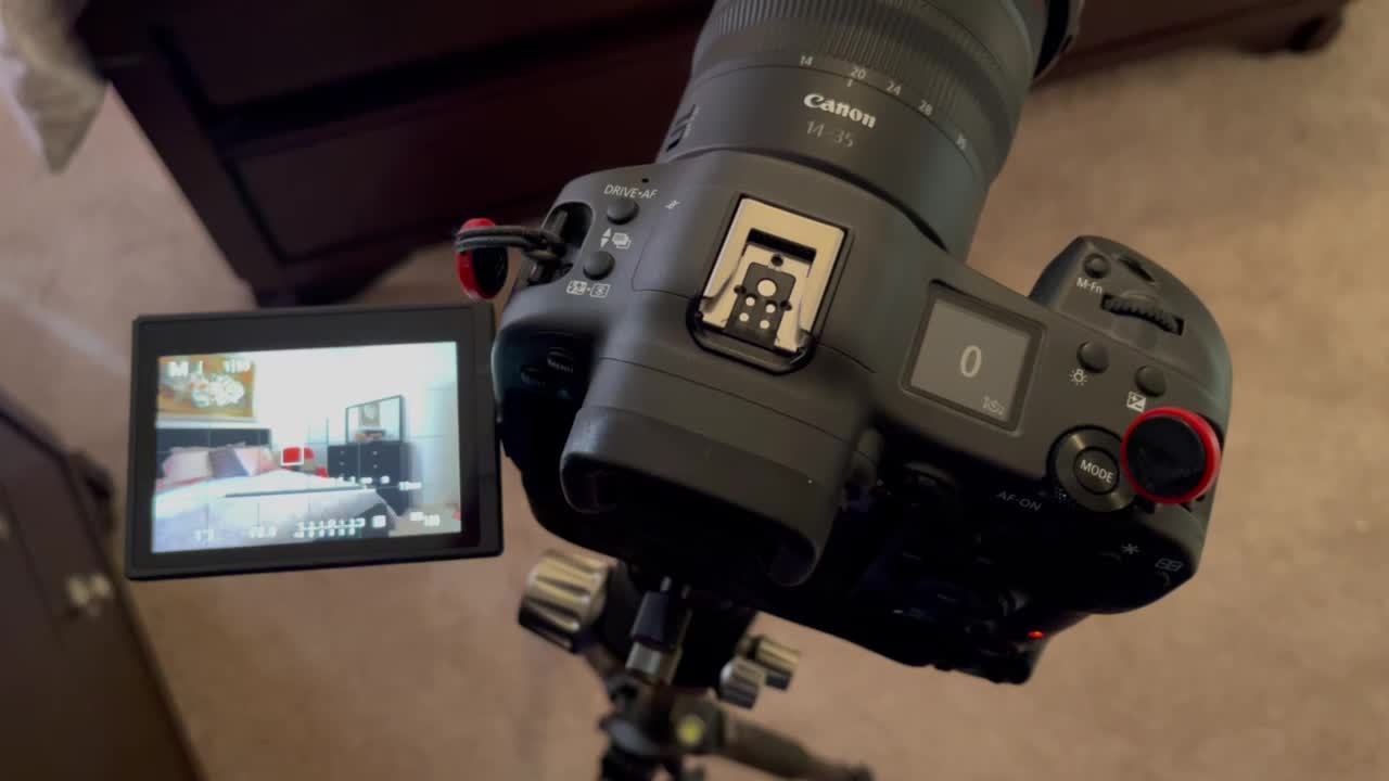

Well, gang, I was able to capture video of the issue before sending it into Canon - I still haven't sent it in because work has been piling up!
It may have something to do with bracketing or when the camera is connected to a bluetooth remote.
I'm not sure when I'm going to be sending the camera in at this point. I haven't been able to spare a series of 2-3 days without a camera and Canon needs my camera in their hands in order for them to send me a loaner...and I am pretty sure getting an R3 as a loaner is probably not going to happen since it's in such short supply. Again, I'll keep everyone posted. I'm going to try and share the video if I can find out how to upload it somewhere for free.

I just used my R3 for the first time since the new firmware update and I immediately ran into issues on my first image. The camera froze up and gave me an error code, then it power cycled on its own and took the photo. This happened between 7-10 times today. I will be sending the camera into Canon first thing next week, as this is unacceptable and they need to find out what's going on with it.
I have well over 100,000 images taken on this camera with the original firmware and this has never happened before, so I know it must be related to the new firmware release.
Please share any of your experience with the firmware here, but I just wanted to let everyone one know they should probably wait on updating...the camera is no longer reliable.
UPDATE: It appears this issue is at least partially linked to shooting bracketed exposures with electronic shutter. I can get the camera fail in E-shutter than switch to mechanical and it works, then switch back to E-shutter and it fails again.
Thanks for posting this. Just got my R3 and I've been experiencing the exact same thing with 5 image exposure brackets and electronic shutter. Switched to mechanical shutter and no issues so far. Wondering if you have had any trouble since, or if you downgraded the firmware. I have no idea where to find the old firmware download. Not on Canon site.
