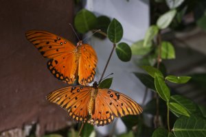

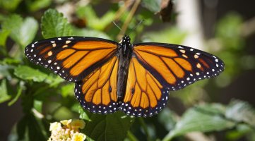

I use the 70-200Z + 2x to take a lot of butterfly shots at high magnification. Not necessarily right at MFD, but often close. My personal take for this lens with 2x at MFD is that "it is much better than it has any right to be". I don't anyone could reasonably be disappointed by it.
Some samples:
Some shots at MFD. This was a TINY fly, and these are very, very deep crops. Still looks quite good imo considering it is only 0.6x magnification

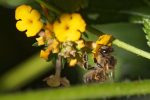

And a honey bee:
Some samples:
And a honey bee:
Beautifully sharp.
Some samples:
And a honey bee:
Nice shots, have plenty of fun with this lens!
