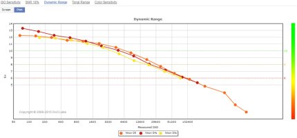

Results now posted: http://www.dxomark.com/Reviews/Nikon-D5-sensor-review-A-worthy-successor
Get a load of this. Compared to the prior D4S and D810:
* Color depth: D810 > D5 > D4S
* Dynamic range: D810 >> D4S > D5
* High ISO: D4S > D810 > D5 (this is a bit misleading -- see the plots for this)
So:
  • The D810's Sony 36 MP sensor is outperforming Nikon's 20-21 MP D5 sensor on all three of DXO's sensor metrics. Let that one soak in. I don't know if that's more of a slow clap for the D810 sensor or a Price is Right failure sound effect for the D5 sensor.
  • The camera that the D5 is replacing arguably has a better sensor in it. Chasing those 4 extra MP with the D5 apparently came at a cost.
  • Neuro is correct. The Canon 80D has more DR than the D5.
...And yet they entitled this article "Nikon D5 sensor review: A worthy successor". Wow.
...And they called the 'predecessor' to the D5 as being the D4 and not the D4S to possibly soften the blow that the D5 didn't get much better. Double wow.
#dxo #fairandbalanced

DPR claimed that with the D5, Nikon sacrificed some low ISO DR for better high ISO performance. Yet...DxO's measurements show the while the D5 has less DR than the D4s at low ISO, it has no more DR at high ISO...and more noise at high ISO.
DPR uses DxO's scores in their 'reviews' – I wonder how they'll handwave around these results... ::)

This (below) is what they are talking about, I believe. Much like how the 24-70 f/2.8 VR they put out seems to deprioritize center resolution to do better away from center than you'd expect, the sensor seems to have been tweaked to not lose a DR as quickly from ISO 1600 - 12800. It's an atypical plot shape for a sensor's DR.
But, as you noted, the noise is higher even if they saved some higher ISO DR from falling off. That's a really nuanced line to walk.

I wonder if the ISO score took a knock because they overstated their ISO more than on previous models. According to DXO, the D5 is only producing an image of brightness equivalent to ISO 66, as opposed to ISO 80 on the 1DX, when the cameras are both set to ISO 100. (p.s. The D4s was ISO 75)
The D5 Sports ISO score appears to be failing the SNR threshold first. This is in contrast to what DPR studio samples presented. Does this mean that:
a) the D5 RAW are cooked with some added NR spices at higher ISOs or
b) the RAW converter is helping the D5 more than older cameras or
c) Other (explain)
