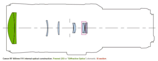

I may have misunderstood your post, but I get the impression that you think Canon's "DO" lenses include a mirror?
As you can see from the diagrams of the EF 400mm F4 DO and the RF 600mm F11, "DO" lenses do not have mirrors, only lenses :).
