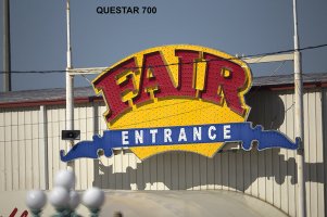

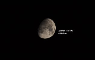

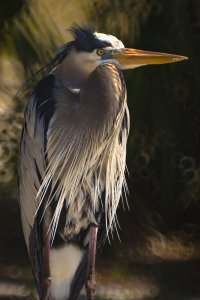

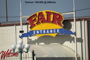

While most of my experience with catadioptric lenses comes from astrophotography with Schmidt Cassegrain telescopes, I have over the years had a couple of these lenses to play with for conventional photography. They ranged from a cheap 500mm POS to the very nice Questar 700, which did well after disassembly and cleaning. Here are some comparison shots with the Q700 and a Tamron 150-600. These lenses have their uses and I would welcome the addition of IS and AF. They'll never satisfy perfectionists and are horrible with specular highlights, but are an economical way to achieve long reach.
