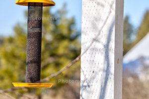

You need to separate the DP RAW images into two files as well as the merged file from the camera. There is software called DPR Split that does this. Then, you stack the images to obtain extra DR.
The top image is the original, the bottom is the processed one.

yup, here:
this won't affect max usable iso in low light. quite opposite, it affects ability to recover clipped highlight.
an extra stop of DR (on demand) is a wonderful feature to have.
