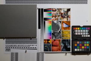

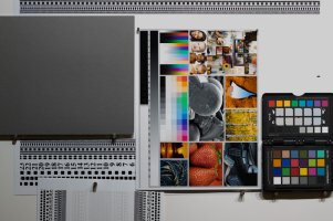

It's interesting in that something seems to have changed in the Canon metering values, all my old cameras underexposed and had a ton of highlight headroom because of that, my new cameras are overexposing cutting highlight headroom but they have much greater capacity to lift shadows.
Personally I make a little test image and dial in my meters and then progressively over and under expose, then pull all those images into LightRoom and see what I am happy doing, what I can save and can't save etc etc. Certainly my latest cameras, even though I have the ability, and have, adjusted the meter offset, do not need an ETTR technique whereas my old ones very much did, I could easily pull over 3 stops down in the highlights, now, not so much but I have a lot more lower end to play with so I tend to expose to the offset meter or lower for midtones.
Here is a sample of my testing image. With this I can calibrate a metering offset and work out how under and over I can expose and retain detail. First image as metered, second over exposed three stops and then pulled three stops.
Great talk, thanks. :)

Private,
If I may, Sir:
new mettering sensors in 5D IV or 80D is RGB type. now mettering sensor sees in colour, if you will.
old cameras were underexposing whites by around 2.8* stops and over exposing black by approx. 2.8* stops, as metering system treated all colors and levels as 18% grey. hence if I was spot mettering for the hilghlights with my trusty 6D, in order to place highlights right at the right edge of the histogram, I would typically increase exposure levels by +2.5 EV.
it turns out that modern RBG mettering system is mich smarter these days and no longer under or over expose buy such a large amount. I had only limited time to play with 5D IV but noticed that to ETTR, I needed only +0.7EV EC for spot metered highlights. blinkies were coming up on the lcd screen for jpgs at +0.5 EV level but really I was able to push RAW another +0.5EV. Again, I have very limited experience with 5D IV therefore all numbers are not exact.
*** -Usable DR of 6D sensor is 5.8 EV ( full is 9.8 EV, but less safety margins: 5.8EV only). old metering system treated spot metered highlights as mid greys and placed them right in the centre of the historgram: 5.8EV / 2 = 2.9EV shift on 6D, (2.7-2.8) EV shift on 5D III.
