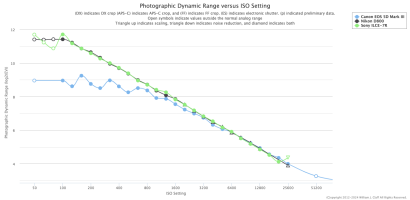

PhotonsToPhotos Results for the EOS R1
I am really surprised (or shocked) at the ISO 100 performance. I will likely set my R1 not to go below ISO 200. Odd that Canon would make the baes ISO 200 and not 100. For what I typically use the R1 for (wildlife photography) I rarely use ISO 100.

TDP's sample ISO12233 crops do indicate that the lens is sharper at 600mm than 800mm.
It's good to see these charts. They happen to be with mechanical shutter (I only use full Electronic shutter, which I absolutely *love* to use), so I'd be interested in charts for that. I wish there were image comparisons to show us as they're easier to me to decide what I like.
But there's something just as important or more (well, to me) to these dynamic range charts, which is the R1 having cross-green AF sensors in the entire image. It can now sense focal information along both up & down planes while the others (AFAIK) only sense 1 and are blind to the other. A sharper/higher in-focus rate image is much more important to me than one with just a slight touch more dynamic range. A poor focused image is just poor. It'd be nice to see how the AF (and in-focus %) compares between them.

Personally, I didn't think 1-1.5 stops of DR was big deal over a decade ago when Canon was 'behind' Sony and Nikon, and I don't think it's a big deal now. I do criticize Sony for claiming there was no less DR on the a9 III (even though I get their logic was the DR is essentially the same at ISO 250 on the a9 II, that's disingenuous at best).
The only difference between the R1 and R3 is at ISO <200 (and as I stated, 1-stop is not a big deal). For me, 6% of my shots with the R3 are at ISO <200 anyway. If someone wants to choose the R3 over the R1 for an extra stop of DR at low ISO, that's their choice. IMO, saving 1/3 of the cost is a far better reason to choose the R3.
My only beef was that they make it a Mark III of an existing line, so it's less obvious that you would take both a dynamic range and a significant noise hit upgrading to a new model.
Looks like a drop from 10.9 to 10 between A92 and A93 in maximum DR, and for equivalent ISOs maybe 1/3-stop at worst.
In fact this is almost the same performance drop between the R3 and the R1 (11.9 to 10.8 in maximum DR, and 1/3-stop drop at equivalent ISOs -- with worse results in the intermediate ISOs because of the higher 2nd gain step and lack of a 3rd gain step in the R1).
I guess technically the R1 is a new line instead of an existing line, but still at least Sony got a global shutter sensor out of it of the large DR drop.

I've always maintained that it doesn't really matter to me what Canon or Sony or whoever calls a camera in terms of model number or "flagship" status. I think the A9III is intended as a successor to the A9II in the same way that the R1 is intended as a successor to the R3, and as their sensors get faster, both of the successor cameras seem to pay a penalty in terms of max DR. That's fine.
In any case, I don't think the people who are actually in the market buying these $6k cameras would be unaware of their limitations.
I'm rather surprised that there hasn't been a jump in DR with the newest technology. Then again, there are physical limits as to how much DR can actually exist, I suppose.
I was hoping for that magic \"one stop\" improvement that would translate to the next APS-C body.
At high iso, DR for most of the good cameras is limited just by the noise caused by statistical fluctuations in the number of photons hitting the sensor. - and the camera circuitry isn't causing loss of DR. The plots of (logs of) DR vs iso are thus a straight line at higher isos, and this line would continue to down to iso 50 or 100 if the camera circuitry didn't start limiting it. Some bodies are getting pretty close to it.
