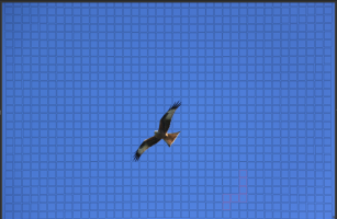

Could you share your current AF settings? And what different things you've tried with the settings? How is it doing with stationary subjects at various distances? Is it happening with more than one lens? How does it work with subjects on the ground but moving somewhat quickly?
Hope it's just a familiarity issue for you!
AF method: :)[]
Motives: animals
Eyedetection activated
AF case 4
kontinuos AF
As an example, the approaching redkite was never detected by the AF in this setting, even when it was filling half of the screen. Pressing the AF button several times did not change the AF-point and the body did not refocus.

We've gotten a lot of info from you, XL+. I hope you are resolving the issue! These questions and discussions help all involved learn more about their cameras, for sure.
I'm stuck home today waiting for my R6. Of course what I will try FIRST is AF!
If others were having AF problems as bad as you, XL+, the Web would be aflame. And all the great reviews we've been reading are fake.
My point? I hope you are within your return window. This terrible performance you are sharing seems to point to some failure within your camera, not trouble learning how to use it.
Please keep us up to date!
