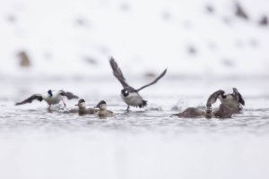

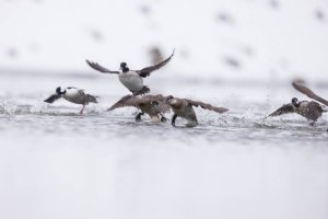

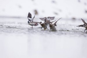

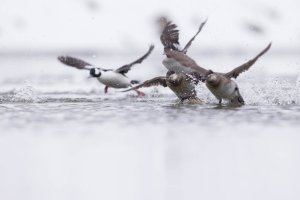

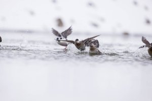

So it was somewhat focused on the ruddy duck then as soon as the ruddy duck starts moving it doesn't keep up. I have tons of shots of birds in flight where it doesn't seem to be able to keep up. Anyone else seeing this? These were shot with the R5 and the 600 f4 v2 at f4 1/1600 ISO2500
