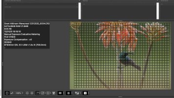

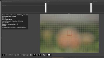

Further to the posts here by Badbird, Bhacker and some others above, and relating to my own use of long focal length EF (in my case IS ii models- the EF 500L f4 IS ii with and without EF 1.4xiii extender and EF 100-400 IS ii ) with the Canon adaptor and the challenges I am having when trying to get focus of a bird or similar subject against a background, I added some screenshots for illustration. R6 with EF 500IS ii and 1.4x ext.jpg
Anytime I used the R6 with adaptor on my long lens to try take pictures of sunbirds on flowering aloe plants, I would struggle with getting focus on the bird. I even tried to then aim the focus point or points, at the aloe flower just to get ballpark focus happening but the camera in my hands failed or else took several seconds to get focused on the flower. I tried with all the focus point options, including Spot. I tried turning the camera vertically but it did not make a difference. The bottom image above shows where I managed to get focus on the flower ends using a cluster of AF points, but even this took what felt like a second or two. I posted the images above just to illustrate that in my hands, I am finding it difficult to get focus on these subjects in what I consider very usable light, and with the kind of backgrounds that I like. So it is very puzzling. It is the first time that I have owned a Canon camera that could do some things very well, like photographing birds in the sky and yet, in my hands, is flawed for taking pictures like this. I struggled equally with bright birds or dark ones. For camera settings I made sure that "Lens Drive When AF Impossible" was switched ON in AF menu AF4. I also tried switching to One shot instead of Servo but found no improvement. I do wonder if it is something that might be improved by firmware or perhaps it is just what happens when using IS ii super telephotos with an adaptor.

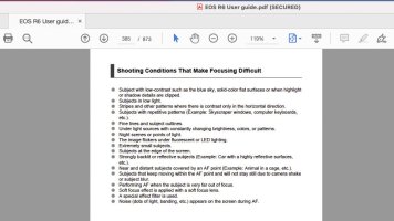

I also referred to the user guide (for the R6) and found this information regarding AF
Seems the difficulties I am having might be listed fourth from the end of the list: "Performing AF when the subject is very far out of focus."
I also checked the Canon owners manuals for the 5D Mk4 and 7D Mk 2, and in their lists of possible AF problems, they do not have this one about a 'very far out of focus subject.' So it is new in the R5/R6 manual.
Maybe Canon already do know about it?

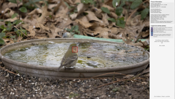

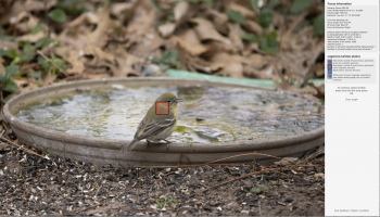

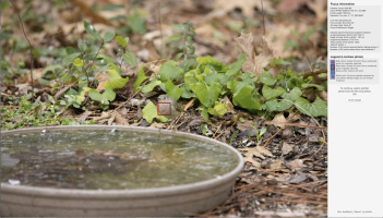

Today my R5 was firing while supposedly locked on small birds (busy birds - Kinglet and Pine Warbler), but the bird was actually out of focus underneath the locked focus point (as indicated by Lightroom plugin) while the background was in focus. This is the typical problem I am seeing with the R5 and 100-500 using spot AF primary and animal eye AF only intermittently. In the first example, the camera thinks it was locked on the Kinglet, but all three shots taken were out of focus.
Typical R5 shot with busy background - 3 shots, bird blurred in all of them.png
The next two show the initial spot AF locked but out of focus versus background, and four shots later the bird is finally in focus under the locked focal point. The exposure and AF point position changed slightly from the first three shots to the fourth, so there is a good chance I tripped the shutter a second time. I was using back button spot AF. So you can lock the AF point on the bird and fire away, but it hasn't always achieved a correct focus on that point.
Another R5 shot where focus was locked on bird but out of focus.pngFour shots later the R5 finally finds the focus.png
