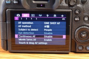

Do you have continuous AF set to enable in menu?
PaulStoffregen
I'm New Here
Jul 21, 2021
11
4
Nope.
Must admit, I completely new to Canon and still learning my way around the menus and so many features.

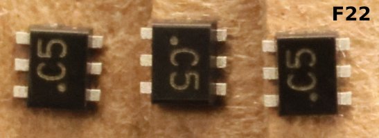

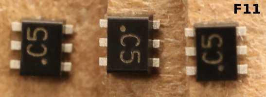

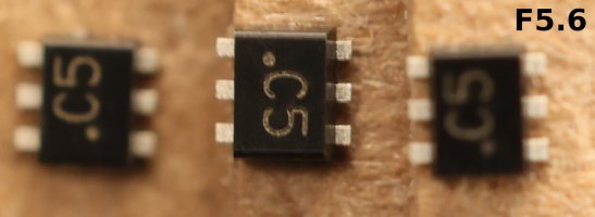

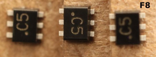

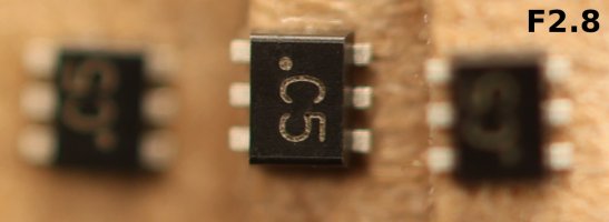

Ok, I'm trying to do a controlled test for focus shift. Please forgive me if this method is flawed (I'm not a pro photographer) and gently explain how I should do better.
For a subject, I put 3 tiny electronic parts onto a little stair-step stand made of card stock.
The card stock is about 1mm thick. These parts are approx 1.6 mm size.
Using my R6, I manually focused on the top surface of the middle part.
This is using the lens at more than 1X magnification but not quite all the way to 1.4X. I tried to get close, but the R6 & lens combo is pretty heavy for my manfrotto magic arm. Sorry, I don't have a nice tripod with fine adjustment (with this much weight on it), so this was the closest I could get after a few tries tightening the arm in place.
Here's the manual focus with double zoom in. With the lens at 2.8F the plane of focus is so thin even the metal legs only about half a millimeter farther away are blurry.
I took several shots at apertures from 2.8 to 22. I'm FTP transferring the images now (my R6 wifi seems pretty flakey and it's giving me Error 46 and retrying). Will crop just the subject and post those image in a few minutes....
