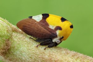

Are these 'great'? I don't know, but I'm happy with them. They were all handheld. The first two are the same mantis that was hanging out in my back yard for several hours.
"Mantis Prey"
EOS 1D X, EF 100mm f/2.8L Macro IS USM, 1/160 s, f/11, ISO 6400

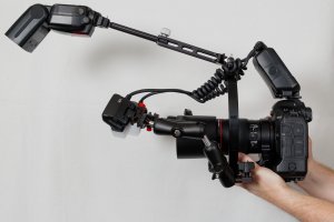

"Mantis" – The 'black' background on this is because of the effective aperture of f/56 that eliminates the contribution from ambient light, so only the subject lit by the twin flash is visible. I have a rig* where I put a regular flash (600EX) on a bracket with an extension to light the background, but in this case the background was somewhat distant and not very interesting so I let it go black.
EOS 1D X, MP-E 65mm f/2.8 1-5x Macro @ ~3x, 1/250 s, f/14, ISO 400, MT-24EX

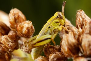

"Little Hopper" – this little guy was <1 cm long
EOS 5D Mark II, MP-E 65mm f/2.8 1-5x Macro @ 3.5x, 1/60 s, f/14, ISO 400, MT-24EX
*Here's that rig:

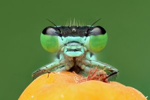

Some examples I just posted here:
https://www.canonrumors.com/forum/threads/butterflies-moths-and-assorted-insects.31073/post-1041670
R5 + RF 100L macro
hand6-jpg.228277
hand5-jpg.228278
hand4-jpg.228279

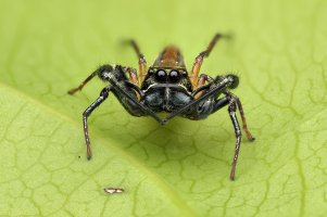

since we are sharing shots of handheld macro... some cropping but pretty small critters :)
Nailing the focus at f2.8 of the blue dragon was tough!
