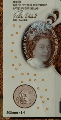

Iv'e done the crops, and they are interesting. First, close up at 5.8m from a £10 note. I have cropped the left hand side with Britannia and upscaled the 500 1.4x with Gigapixel (500mm x 1.4) and compared with the 100-500+ 1.4xTC (700mm). The analog upscaling with the extender does eke out a little more detail, but loses acutance (edge sharpness), and I am not sure I would recommend it.
309A8534-DxO_500mm_f7.1_5.8m-gigapixel-scale-1_40x crop.jpg 309A8566-DxO_700mm_5.8ss_crop.jpg

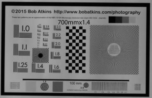

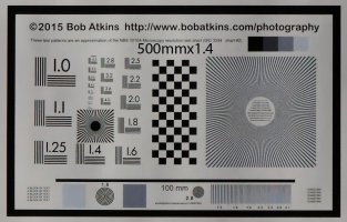

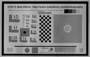

At longer distances, it's a different story, using that damn chart. At 19m with the R5 again. Top, 100-500mm bare; next upscaled 1.4x with Topaz Gigapixel; then 1.4xTC on the 100-500mm TC at 700mm; bottom, the 700mm upscaled 1.4x. The extender allows the 2.8 circles to be resolved and finer spaced lines to be resolved. The extender could be worth it an a number of circumstances. You'll need to download to compare properly.
309A8523-DxO_DO__500mm_f7.1_19m_ss_Ann.jpg 309A8523-DxO_500mm_f7.1_19_m-gigapixel-scale-1_40xAnn.jpg 309A8496-DxO_420-700mm_19m-ssAnn.jpg 309A8496-DxO_420-700mm_19m.1_40xAnn.jpg

At longer distances, it's a different story, using that damn chart. At 19m with the R5 again. Top, 100-500mm bare; next upscaled 1.4x with Gigigapixel; then 1.4xTC on the 100-500mm TC at 700mm; bottom, the 700mm upscaled 1.4x. The extender allows the 2.8 circles to be resolved and finer spaced lines to be resolved. The extender could be worth it an a number of circumstances. You'll need to download to compare properly.
View attachment 194558 View attachment 194559 View attachment 194560 View attachment 194561

Thanks - I got all 4 downloaded. It's pretty clear that the R5 & 100-500 at that distance doesn't have the pixels to resolve the smallest lines, and moire starts taking effect. Upsizing can't fix what's already gone moire. Adding the 1.4 TC gives it enough enlargement so moire doesn't happen much, and then the upsizing does a good job on it since it didn't moire out to start with.
So it looks like a very clear winner for using the RF 1.4X with the 100-500L lens over just cropping & upsizing. I guess I should consider a RF 1.4X TC now.
