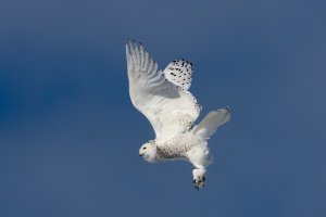

I picked up the 400 DO II and a 1.4x III. I am having an issue with focus consistency. When the bare lens or the lens with the 1.4x hits focus it is sharp, unfortunately, the hit rate is very low (especially with the 1.4x). Even with large stationary targets like a parked car's licence plate. Greater than 50% are slightly out of focus, even with good lite conditions.
I use servo focus with back button focus with eye-tracking or single spot.
Could this be an issue with the IS? Any ideas?
My R5 has amazing focus consistency with the rest of my lenses including the F 1.2 lenses.
Please post an example or two with the shutter speed so we can see whether it is a camera shake problem.

In this folder, I have a few raw files. Image _F2A6691 was indicative of a whole string of 30 shots that were out of focus. The other two pairs of images show the variations between in focus and out of focus I get, with ~50% or more being slightly out of focus. One example is with the 1.4x the other is without. In both cases the shutter speed is fairly high.

I've looked at them. Only 1/4 is acceptable. _F2A6691 certainly is not. Something is wrong. 1/1000s should not be affected by the IS - I would have used 1/2000s f/5.6 rather than 1/1000s f/8 as there is little point in stopping down. Is the lens new or used? In either case, I would send it back as there are no distracting features in the background that would upset the focus.

I was using f8 because I was waiting for the owl to take off and didn't want to have the owl move out of focus as it launched.
I agree that under this scenario, clean background, good light, there shouldn't have been an issue. Some images were focused well but way too many did not. I am going to upgrade the lens firmware and do some additional testing.

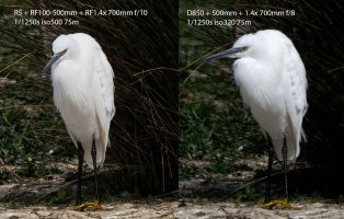

I just came across some comparisons I did with the R5 + 100-500mm vs the D850 + 500mm f/5.6 PF last April/May. First some crops reasonably close at 500mm, then some very far away at 700mm with the 1.4x TCs, all at 100% crops (1px = 1px of original). They illustrate what I wrote. There's not much between them, if anything.
Male_Mallard_500PFvs100-500mm.jpgFemale_Mallard_500PFvs100-500mm.jpg Cormorant_500Pf_vs_100-500mm_700mm.jpg Little_Egret_500Pf_vs_100-500mm_700mm.jpg
View attachment 201906View attachment 201907View attachment 201908View attachment 201909
Edge to Nikon but not at 700 IMHO but you're right, not much difference.
Jack
Once again, thank you AlanF for providing these sample photos. Much appreciated by me. For my eyesight, they both look pretty good. :)
