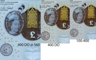

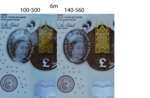

2. Close up for dragonflies and insects
I have been using the Nikon 500PF for this purpose as well as birds because it is spectacularly sharp at its minimum focal distance of 3m and short distances. I found the 100-400mm II softish close up. So how does the 100-500mm compare. The £10 note has a wide range of colouring, shading, embossing and sharp lines. I have just to illustrate the sharpness here used crops of Britannia from the bottom left, which has some useful concentric lines, and the head of our Queen, which is in grey but with some colouring on here face made up of alternating grey and white squares that merge as distance increases or as contrast is lost by the lens.
£10 note at 3m
100-500mm much better than 140-560mm and 100-400mm, not as good as the 500mm PF gold standard but getting there.
£10 note at 6m
100-500mm again much better than 140-560mm and 100-400mm, not as good as 500mm PF, but better than 400mm DO II and about same as 560mm DO II.
You can see all this from the crops in the next post, looking at Britannia’s rings and lines and the Queen’s face grey colouring. (I didn't correct the white balance here).
Conclusion
The RF 100-500mm is a real improvement over the 100-400mm II at close distances if you need high resolution and cropping. For me, this makes the RF lens worthwhile as I can use a single lens for a trip photographing insects and birds.

One of the questions asked about the RF 100-500mm is whether it’s worth upgrading to it from an EF 100-400mm II plus adapter. The consensus so far is that if you are starting from scratch, then it makes sense to buy into the RF system but if you already have the excellent EF lens then there is not that much to be gained by discarding the excellent 100-400mm II. Although the RF is back-ordered everywhere in the UK, some copies appeared on the European Canon site and I couldn’t resist one. The 100-500mm arrived Thursday afternoon and I managed to get some preliminary analysis when it hasn’t been raining from the point of view of someone who likes a lightweight lens for hiking and taking photos of birds, perched and in flight, close up and distant, and dragonflies and butterflies close up.
I have compared it on the R5 with the EF 100-400mm II f/5.6 and 400mm DO II f/4 with and without a 1.4xTCIII, in particular. In general, all three are spectacular for AF, both for latching on to fast flying birds and the eyes of closer ones. As for IS, I don’t see much of an R improvement in my hands when looking for pixel level sharpness and I needed to get down to 1/160s for 50% absolutely tack sharp at the pixel level at 20m.
The websites that report on lens sharpness usually do so at just one undefined distance. I want to know how sharp a lens is close up, mid distances and further away. So, I have done some tests using a UK £10 note at 3 and 6m, and black and white resolution charts at 12 and 20m. The RF 1.4xTC is arriving next week and I’ll report on the lens at 700mm then.
The site has compressed the attachments so I have chopped them in two, the top pair at 3m, the bottom at 6m. Each part of the collage is a 100% crop (1 pixel of crop = 1 pixel of original image without resizing) taken on an R5.
View attachment 194477View attachment 194478View attachment 194479View attachment 194480
