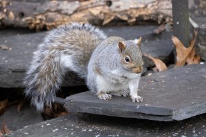

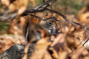

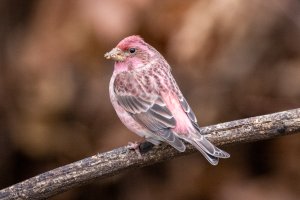

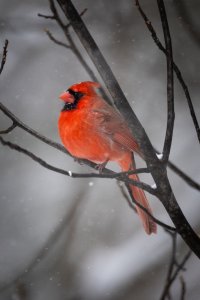

So...I've now had the RF 200-800 for 2 days of shooting. But, here are some photos from day 1. All of these were taken at my backyard bird feeder. I tried to do a trip to shoot eagles, but the river had iced over and the eagles had moved on.
As for impressions (all on R5 with latest firmware)....this is a good, maybe even a very good lens. It is interesting to hear people talk about how big and heavy it is. I guess it is a matter of perspective, I am amazed at how light and handholdable it is for what it is (800 mm). A joy in that department. I really like the focal length range. I am getting a number of good, usable images and can absolutely see this being many photographers primary/only telephoto lens.
Before I start with the not so good impressions, I must admit, I had lower light conditions on Saturday (cloud cover with winter storm moving in) and Sunday (snow storm). But the AF has been a bit inconsistent and while it is producing good usable shots, when I pixel peep, there are very few absolutely tack sharp images. There are good, even very good, but tack sharp eye detail was only present in a handful of images. And those were mostly when the sun popped through the clouds on Saturday. The AF seems to be having some trouble keeping up with subtle movements of the birds under lower light. It would bounce from on eye to on body more often than I am used too (and set to eye-AF animal, servo mode). The 200-800 would also loose focus often and hit rate was getting low. To test, I did use this side by side with my EF 500 II +1.4tc which gave me the usual of dead on AF, tack sharp images on the eyes, and back up to 9+/10 usable/very sharp images. Then I even pulled out my Simga 150-600S (haven't used in years, really should sell). I was pleased with how well the Sigma did actually. But I would say the 200-800 is on par or slightly better.
Sun is shining today. I'll do a few more tests and even get the EF 100-400 II w/1.4xtc out to compare. But, I think this may be pretty close to my final conclusion....there has been a breed of very good super-telephoto zooms (out to 600 mm) on the market starting by Sigma, but the big brands have caught up. Typically these are in the $1,000 to $2,000 price range. Many great images have been taken with these lenses and many more will be. Canon has now released a really good lens that may even be a leader in that category.
So, great! This will end up in many kits. I can see myself recommending this to many people. This is a good to very good lens. But, does it fit in a kit of someone that already has a EF 100-400 II and EF 500 II? Maybe. I'll see how it does under sunny conditions.

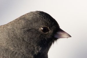

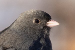

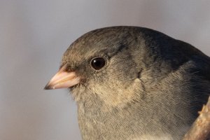

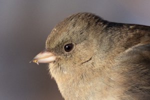

There seems to be enough interest, I thought I'd share this part of my evaluation of the RF 200-800.
Limited to my backyard set up that consists of my feeder with a stand that are about 30 ft away from my office window. The Juncos have been hitting my feeder a lot lately, so using the R5 I took out the 200-800, Sigma 150-600S, EF 100-400 w/1.4tc, EF 500 II, and EF 500 II w/ 1.4tc. I took about 40-60 shots with each set up within about 25 mins. The settings were 1/1000, f/8 or f/9, and ISO 1000. These are unprocessed images scaled in LR to 1500x1000. Eye-AF set to animal in servo was used.
Cropping in for some Junco headshots:
A)
B)
C)
D)
E)
F) (bonus)
The key:
A: RF 200-800 (maybe focused just in front of the eye, but I saw this several times)
B: EF 100-400 II w/ 1.4tc
C: EF 500 II
D: Sigma 150-600 Sport
E: EF 500 II w 1.4tc
F: RF 200-800...I like this one a lot.
I am impressed. I still prefer the 500 II w/1.4tc, but the RF 200-800 was close enough I am very impressed.
But...at least for this one guy on one afternoon with a bunch of lenses and a camera, this test also elucidated key difference. Hit rate.
This is very subjective, and a small sample size, but under ~EV 13 conditions, out of the 30-60 images I took with each combination, I considered the following to be "sharp":
Sigma 150-600S: 87%
EF 100-400 II w/ 1.4tc: 76%
EF 500 II: 100% :)cool:)
EF 500 II w 1.4tc: 87% (I shot less with this combination and hit one bad stretch)
RF 200-800: 68%
So, pretty good light, and the RF 200-800 was most prone to lose focus. Checking on the conditions Sunday, it was EV 11 during the snowstorm and I still got good images, but the AF did struggle.
Had the RF 200-800 been available when I was upgrading into the super-telephoto range...it would have been my first super telephoto lens. I can easily recommend it. The IQ is great. But if AF/hit rate is critical, just be aware that is where this lens struggles especially in lower light.
I am still going through images from the storm, but I did like this one (taken with RF 200-800):
