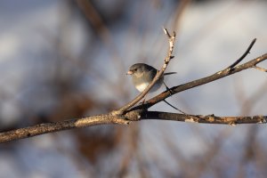

There seems to be enough interest, I thought I'd share this part of my evaluation of the RF 200-800.
Limited to my backyard set up that consists of my feeder with a stand that are about 30 ft away from my office window. The Juncos have been hitting my feeder a lot lately, so using the R5 I took out the 200-800, Sigma 150-600S, EF 100-400 w/1.4tc, EF 500 II, and EF 500 II w/ 1.4tc. I took about 40-60 shots with each set up within about 25 mins. The settings were 1/1000, f/8 or f/9, and ISO 1000. These are unprocessed images scaled in LR to 1500x1000. Eye-AF set to animal in servo was used.
Cropping in for some Junco headshots:
A)
B)
C)
D)
E)
F) (bonus)
The key:
A: RF 200-800 (maybe focused just in front of the eye, but I saw this several times)
B: EF 100-400 II w/ 1.4tc
C: EF 500 II
D: Sigma 150-600 Sport
E: EF 500 II w 1.4tc
F: RF 200-800...I like this one a lot.
I am impressed. I still prefer the 500 II w/1.4tc, but the RF 200-800 was close enough I am very impressed.
But...at least for this one guy on one afternoon with a bunch of lenses and a camera, this test also elucidated key difference. Hit rate.
This is very subjective, and a small sample size, but under ~EV 13 conditions, out of the 30-60 images I took with each combination, I considered the following to be "sharp":
Sigma 150-600S: 87%
EF 100-400 II w/ 1.4tc: 76%
EF 500 II: 100% :)cool:)
EF 500 II w 1.4tc: 87% (I shot less with this combination and hit one bad stretch)
RF 200-800: 68%
So, pretty good light, and the RF 200-800 was most prone to lose focus. Checking on the conditions Sunday, it was EV 11 during the snowstorm and I still got good images, but the AF did struggle.
Had the RF 200-800 been available when I was upgrading into the super-telephoto range...it would have been my first super telephoto lens. I can easily recommend it. The IQ is great. But if AF/hit rate is critical, just be aware that is where this lens struggles especially in lower light.

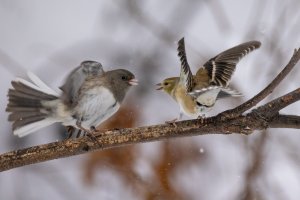

I am still going through images from the storm, but I did like this one (taken with RF 200-800):

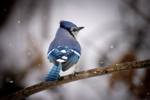

Making my way through phots I took during the snow storm. I often do not get Blue Jays at my feeder, they tend to stay in the trees. So I was happy to get these:

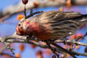

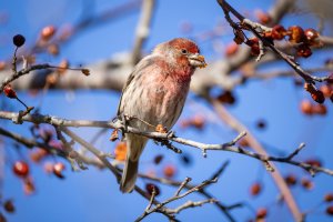

So a little more light today and down to ISO 3200 on the R7 for the hummers. These shots are all 100% crop and other than running "enhance" to get rid of the noise and a few minor lighting adjustments, these are default LR processing with no additional sharpening. The fist two are at 800mm and the last (the bird with big ears) is at the other end at 200mm. This 200-800 is a very sharp lens over the full range.
