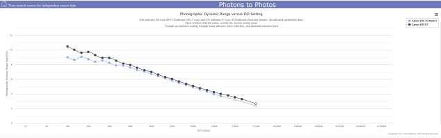

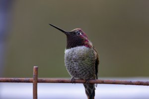

It depends on what you want to do with the camera. I use the R7 when I want maximum magnification and the R5 for most other shots unless traveling light and then it will be the M6 II. With Adobe Enhance or PL7 Prime xd, the R7 is very usable at ISO 6400 and the R5 to about 16000. The R5 has a faster readout and larger pixels, so the AF works better in low light than the R7, but that said, I have no problem with the R7 focusing on hummingbirds in low light with an f/11 lens (as you can see from the above shot at ISO 6400 and 1/100 sec). I can't make a judgment relative to the 7D II AF, because I have never used one, but compared to the 70D or 90D, the R7 is much faster and far more capable with modern subject recognition. If you have a bunch of glass that you bought for optimal use with the 7D II, then it will only be be better with the IBIS on the R7. The below chart shows what you can expect in dynamic range improvement relative to your 7D II. The useful noise improvement is more, thanks to the very fine grain noise from the R7 and how well it can be managed by AI noise reduction.There are several of you that I see are using the R7. It seems like the sensor is rather decent and handles noise quite nicely above ISO 3200. How does that camera compare to the 7D mkll??? I was pretty disappointed when it was first announced, as I would have gladly paid $500 more for a stacked BSI sensor and dual CF express slots. The terrible buffer and old technology in a new camera body have kept me from upgrading to the mirrorless body. I almost pulled the trigger on the R5 refurbished for 2299 on black Friday or whatever it was. But didn't because it's 3.5 years old. Since I'm stuck in the Canon system with my lenses I'm just going to wait out my 7D mkll until it's dead! I'm pretty sure I'll end up with the R5 mkll as my 7D has over 1 million shutter count
Thank you for the detailed response. I guess I did not fully look into the CRAW before. I've been seeing pretty decent photos at ISO 6400, which is why I was asking. I don't think a really close up photo of a subject at a high ISO is a good judge of the capabilities, though. Something 50' away or more would better show what can or can't be done at ISO 6400, especially for smaller birds, IMO. I think I've had my mind made up for a while now, that I'm finally going full frame. Otherwise, I would have purchased the R7 for $999 on Black Friday.As to the card slots, SD UHS II cards can be quite fast if you are willing to pay for the V.90 cards. I don't think CF Express cards would make a meaningful difference in the performance of the camera and they would make it unattractive to likely more the half the buyers who are happy to use the SD card readers built into their laptops.
You may find that the R7 Buffer is not as limited as you think. Download the manual and read the specs carefully. If you shoot CRAW and have a fast card, the useful buffer depth at 15 fps is 187 frames, which is many times more than your 7D II.

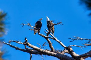

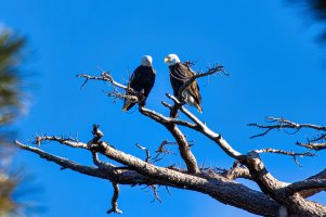

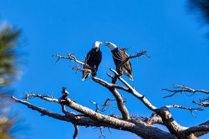

So greatFound a pair of Bald Eagles today that were engaged in some funny conversation. They were rediculously far away, almost like ants with the naked eye, but I attempted some shots, regardless. Was using an R7 with 100-500+1.4X extender.

I'd need a 14,000x extender to get that shot! The 1.4x works pretty well with the R7 + 100-500 for some reason. I'm in extender testing mode.Found a pair of Bald Eagles today that were engaged in some funny conversation. They were rediculously far away, almost like ants with the naked eye, but I attempted some shots, regardless. Was using an R7 with 100-500+1.4X extender.

Yeah, I was quite surprised, Alan!I'd need a 14,000x extender to get that shot! The 1.4x works pretty well with the R7 + 100-500 for some reason. I'm in extender testing mode.
Bright light like you had, useful. Dim light, forget them.Yeah, I was quite surprised, Alan!
