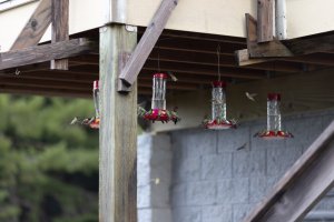

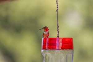

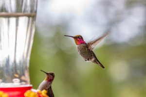

They come very close when new feeders are being installed. They literally buzz my wife like a swarm of bees :ROFLMAO:. I have lots of close-up feeder pics, but I try to catch them in a more natural environment in the brush where they hang out as they take turns (sort of) at the feeders. So far, I haven't had one land on the camera, but the ones that live here are not very shy. The summer visitors (mostly Rufus) are much more skittish and hard to get close to, but the resident Annas are very friendly. A few examples below. The first is with an EF 135 f/2 and the R5. The second is with the 135 and a 90D. The third is with the R5 and an EF 100-400 L II at 400mm. That is the somewhat shy (with people), but very bossy Rufus who is trying to keep everybody else off the feeder. As you can see from the first shot taken in Dec 2021, we have winter birds. All shots are uncropped, but scaled to 4k.

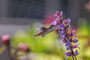

Sounds reasonable, but also sounds like you need to attract some more birds. Be aware that they prefer the all plastic and glass feeders. Anything with metal that contacts the nectar will put them off. If you have planting room, they love hummingbird bushes and I have a sage plant in the spice planter that has purple flowers that they seem to like a lot. See below. I have noticed that they are less approachable around flowers than they are at the feeders, for what that is worth.
Picture shot before I got the R7. Note that when you take all the scale factors into account, the illumination (and magnification) per pixel is almost identical between the R5 with 1.4 TC and the R7 w/o the TC. Performance is very similar, but the R7 package is lighter and slightly less CA w/o the TC.
R5, 800 f/11 + 1.4x TC @ ISO 2500, f/16, 1/800 s uncropped, scaled to 4k
