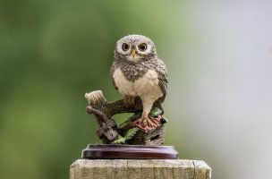

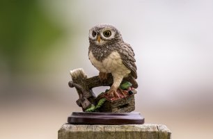

Jack is right. When I test new lens or camera I use a little owl, see pictures. Here I was testing the lens sharpness on a new 100-400ii with extender on both the canon 5dmkiii and 7dmkii. My opinion both are extremely sharp.
