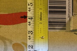

1 AM, no moon and too cold so I just tried a shot of a rule at 45 degrees hand held. It wouldn't lock focus with my 6D and 300 II but I only had my 36mm tube to try out (12/20 is lent out). 2X is closest to the camera. This isn't a very good judge of IQ for sure but it resolves better than 128th inch at 10'.

When I get my 12 mm back I'll try again but I'm not impressed with this although there might be a circumstance where I'd try it. ISO 4000 Had to manually focus (auto was spotty) and it was tricky hand held.
