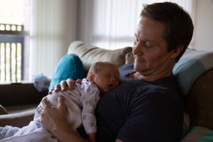

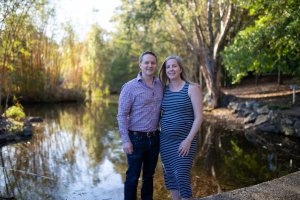

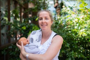

In recent months I have been trying out live view with face tracking AF on my 6DII, for portraits with fast prime lenses. When it works well, the AF is very accurate even at wide apertures, and I do see the potential advantage in that regard over traditional DSLR AF. However, I get a surprising number of blurry photos, and they remind me of the sample blurry image YuengLinger nitsuga has posted in this thread. The photos don't seem have the plane of focus in the wrong place, they seem to be blurry all over. I thought at first it must be user error, but it has kept happening despite me being more careful about holding the camera stable. Now I'm wondering if I'm seeing the same issue that this thread is about?
Of course, I'm not using an R5 or R6 and there is no IBIS on my 6DII, so maybe my issue is completely different.
If relevant, I am seeing the issue with Canon lenses and Sigma lenses, with my zooms as well as my fast primes, and with lenses with and without IS.
Below are three examples, taken with a Canon 70-200/2.8L IS II, Sigma 35 Art and Canon 24-70/4L IS. As mentioned above, not all shots I take with live view are like this (some are great), but I get patches where I seem to get a group of blurry shots like these ones.

I missed those images previously. They look like defocus blur to me, not shake. Especially the man with the baby, his shoulder is much sharper than the more distant parts of the image.
Have you made any adjustments to AFMA in the camera or perhaps with the dock in case of the sigma lenses?
I know I haven't made any changes via the Sigma dock, but I'd have to check AFMA adjustments ... but I didn't think AFMA was relevant when shooting in LiveView?

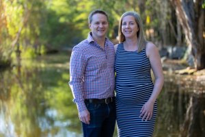

I've attached four shots taken at 1/100th of a second, f/2.8, ISO 640. Window light. The file names indicate which ones were taken with EFCS or Mechanical, IBIS or no IBIS.
They were all taken with an Rf 24-70mm f/2.8L IS at 35mm. I found the same results at 24mm, but didn't test at a longer Focal Length. I also found similar results, but not as pronounced using an ef 35mm f/1.4L at the same settings.
I took the same shots at 1/200th and found that, at 100%, the shutter shock was barely detectable, not a real world factor, but if I zoomed in to 200%, I could see the tiniest bit of difference. Really not any issue, imo.
I did the same tests at 1/30th of a second (ISO 160), and I've attached two of those to show that there is still visible shutter shock, though not as bad as at 1/100th. Both were taken with NO IBIS because the results were pretty much the same with it on, and because I think most photographers at 1/30th are going to choose no IBIS on a tripod. I do know that 1/30th is in the range dSLR shooters would use mirror lock-up, but I will admit I thought the blur at around 1/30th in dSLR's was caused by the mirror. I guess the mechanical shutter is involved there too.
For myself, I have to put some perspective on this. The R5 shows shutter shock at 1/100th of a second with mechanical shutter. This is aggravating because I tend to shoot quite a lot indoors from 1/60th to 1/160th, and I'm USED to mech shutter, I trust it. But I have been taking photos under LED with EFCS, and I'm not seeing any drawbacks in my images. So all I have to do is remember to switch to mechanical outdoors, bright light, wide apertures to avoid the bokeh problems. Am I missing any EFCS drawbacks here that might bite me someday?
Another perspective that helps me deal with a less than absolutely perfect camera, I know that shutter shock has been a quiet issue for decades, and that we learned to work around it when shooting in that slower shutter-speed danger zone. I can still work around it easily here, but I just have to remember which Shutter Mode to use in various situations. I think for the most part, as a portrait and events photographer, I can use EFCS most of the time. Bright sunshine and higher shutter speeds, go to mechanical.
Can this be fixed with a firmware update? If not, would Canon make some change in production to improve the vibration issue? If so, where would that leave us early adopters?
