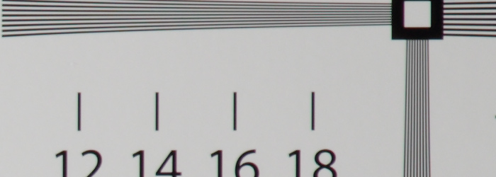

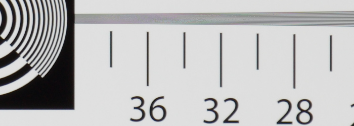

Its interesting to compare the lens at 400mm on the 7D MK II wide open at f/5.6 versus wide open on a 1Ds MK III with 1.4X TC. Note, the lens is better wide open than stopped down, and matches the FF in the corner, but not quite in the center when wide open.
The images are very carefully set up and manually focused to be the best the camera can do. The 7D MK II is a hair better than the 60D, since it has a few more MP, the improvement is proportional.
I wish he had included the 1D MK IV in those tests.
7D MK II at 400mm f/5.6 (center)
7D MK II at 400mm f/5.6 (corner)
1DS MK III with 1.4X TC wide open - f/8 (center)
1DS MK III with 1.4X TC wide open - f/8 (corner)
The 7D II looks a bit better in this comparison, but keep in mind you are only gaining a bit over 14% in reach advantage. 560mm vs the "crop factor" reach of 640mm. We hear often the (1.2x) 20% to (.3x) 30% thrown out as what is really realized as a crop factor benefit.
If you look at the 7D II at the "actual" length of 400mm vs the FF, the FF looks much better.

So if we look at these charts it would lead us to believe we would get a bit more reach with the 7D II. This sound very good. But this is a zoom lens, and that cripples the benefit, why buy a zoom lens to only shoot at the longest length like a prime? Any shot you can make under 400mm that can be properly framed will have a greater benefit in IQ with the FF than the gain you make in reach using the crop. This is just something to weigh out if a person is choosing a body to go with the lens.
