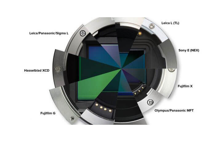

I love this diagram and explanation, but Sony has stated repeatedly that the mount diameter doesn't limit their lens design. I think they also claimed that the E mount could theoretically take f/0.95 lenses, but that they didn't have any planned. Would an f/0.95 lens also feature huge elements at the front of the lens and smaller ones at the rear, thus changing/throwing off the balance on the body? According to what you've posted, quite possibly.
Would you really expect Sony to admit any fault with their mount though? Not likely. Theoretically they can make just about any lens, but they don't have the same freedom of design. Which we'll see as time goes on. There's a good reason Nikon's mount jumped by nearly 10mm from the DSLR to mirrorless.
Exactly. A Sony engineer gave a public talk in Japan in which he admitted that there was a heated debate within the company as to whether they should retro-convert their APS-C E mount into a 35mm format mount. That suggests that there were almost certainly dissenters amongst the Sony engineers who questioned the wisdom of doing this. It is quite possible (although this is speculative) that the decision to proceed with a 35mm format mount with APS-C dimensions was made more by the marketing department wanting to draw first blood over Canon and Nikon and that the engineers were overruled.
Naturally, the marketing department at Sony will not admit to any errors. However, it is rather damning to think that three firms founded APS-C mirrorless mounts around the same time: Canon (M mount), Sony (NEX/E mount), and Fuji (X mount)—but only one of these companies has retro-converted their APS-C mount into a 35mm format mount. Other firms could have designed a 35mm mount with APS-C dimensions but none have. Leica hasn't, nor has Sigma, Panasonic, Canon, or Nikon. That's a lot of engineers from lots of firms across the world to shun the Sony approach. Sony is out on a limb, totally isolated, leaving its marketing department to predictably spin the supreme wisdom of their decision.
Sadly, I rather fear that the success of the Sony FE mount represents the success of marketing strategy over good engineering.
"... This ‘glass at the rear’ design is what allows this lens to be both shorter and lighter than other 70-200mm lenses...".
the above suggests that RF 400 F2.8 lens can be much lighter than EF 400 F2.8 III. I am thinking around 2.3kg ???
Of course, Sony would claim this. Sony issued this denial only with respect to the particular concern that the FE mount would not be able to support ultra-wide apertures. That is NOT the criticism of an ASP-C dimension 35mm format mount that Canon has come up with. The Canon internal R&D department state that they found that if they retro-converted their M mount into a 35mm format mount that it had negative repercussions on the ergonomics of the lens, making it front heavy, and requiring extra corrective elements i.e. a small and cramped mount means larger, more expensive, imbalanced and front heavy lens.
Fuji has also come up with similar criticism of the Sony FE mount based on what they call the "value angle" which simply implies that the dimensions of the FE mount hinder good lens design. This has also been recently the subject of a thread here:
Clearly, it was hardly in Fuji's self-interest to come up with this concept (although it won't stop Sony fanboys from dismissing it as self-interested Fuji propaganda). But it probably represents a fair consensus statement of what engineers within the optics industry overall think of the Sony FE mount.
Again, if retro-converting an APS-C mount into a 35mm format mount was such a fantastic idea (as Sony will predictably claim) then Canon would not have bothered spending a lot of time and money starting a new mount system from scratch, with Nikon independently coming up with its Z mount with almost an identical mount diameter to Canon.
One more critical point. It is in Sony's vested self-interest to claim that a 35mm mount with APS-C dimensions presents no optical engineering limitations. It is in Canon's vested self-interest to claim that their time and effort in developing a new 35mm mirrorless mount with optimal dimensions has been worth it and the result of a superior engineering decision. Which should we believe?
The answer is we need an independent assessment of these rival claims. That's why Roger's statement, which I repeat again, is so important:
Canon claims that the shorter back focus distance with a wider opening allows them to place larger elements closer to the sensor to achieve this. The fact that the rear element is a large aspheric with subwavelength coating, and that the other rear elements are large, supports this.
This should not be read as Roger definitively endorsing Canon's engineering department, but it is a tentative first step towards that. I think, watch this space.
As an aside, this is bad news for those interested in third party lenses for the RF mount. The Sigma CEO has said that they need to make their lenses work for all mounts starting with the most restrictive one, which in this case is the Sony FE mount. That means that Sigma won't be able to place large lens elements near the sensor for any of their native mirrorless 35mm format lenses. The limitations of the Sony FE mount will be endemic to both the Canon and Nikon versions of their mirrorless lenses. Ouch.

actually, Roger then went to say:
which is quite a statement. so here is the confirmation you were looking for. right there.
As an aside, this is bad news for those interested in third party lenses for the RF mount. The Sigma CEO has said that they need to make their lenses work for all mounts starting with the most restrictive one, which in this case is the Sony FE mount. That means that Sigma won't be able to place large lens elements near the sensor for any of their 35mm format lenses. The limitations of the Sony FE mount will be endemic to both the Canon and Nikon versions of their mirrorless lenses. Ouch.
I wonder if they'll stick with that for their L mount designs and if not, will they offer them in RF and Z and leave out FE?
