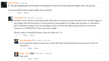

    Interesting comment from Roger!
    "Before we start, though, let’s get the extending barrel discussion out of the way. Some of you HATE extending barrel lenses. That’s cool; don’t get one. Some of you like to call them dust pumps. That’s cool, too, although it’s incorrect. (We take care of over 20,000 lenses. The most common ‘dusters’ among current lenses all happen to be primes that don’t zoom at all.) "

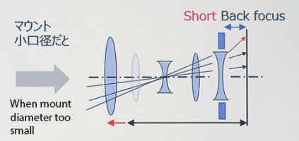

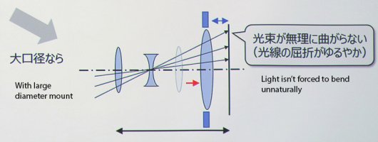

    The most important thing in this article was this statement: "Canon claims that the shorter back focus distance with a wider opening allows them to place larger elements closer to the sensor to achieve this. The fact that the rear element is a large aspheric with subwavelength coating, and that the other rear elements are large, supports this".
    Canon stated that they experimented with copying Sony by retro-converting their APS-C dimension M mount (almost identical in flange distance and diameter to the Sony E mount) into a 35mm format mount, but they found that the cramped APS-C dimension mount forced engineers to place heavy lens elements on the end of the lens and that you couldn't place them close to the sensor as you could with a large diameter mount (with a "wider opening" as Roger puts it). You also needed extra corrective elements to get the light to bend unnaturally into the sensor corners. These diagrams come from a presentation by Canon at the time the EOS R was released (I have added my own translation to Canon's captions).
    So it's not just about being more compact in size but also less front heavy and imbalanced.
    It took Canon longer to enter the 35mm mirrorless market because they had to build their 35mm mirrorless system from scratch. The Sony hare only managed to get in front of Canon and Nikon by taking a dirty little shortcut in retro-converting an APS-C mount into a 35mm mount, but this has left a critical vulnerability that the tortoises are going to slowly exploit. Are Sony ******* yet?
    I love this diagram and explanation, but Sony has stated repeatedly that the mount diameter doesn't limit their lens design. I think they also claimed that the E mount could theoretically take f/0.95 lenses, but that they didn't have any planned. Would an f/0.95 lens also feature huge elements at the front of the lens and smaller ones at the rear, thus changing/throwing off the balance on the body? According to what you've posted, quite possibly.
