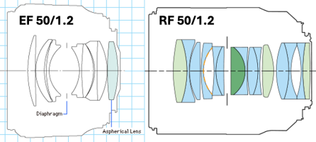

It’s the lens optics. The EF 50/1.2 is the standard double Gauss design that’s been around almost as long as lenses, the RF 50/1.2 is a modern design that delivers much better performance.
The RF version has 15 elements (including 3 aspherical lenses and a UD lens) vs. 8 in the EF (with just one aspherical lens), and as a result the former is 400 g heavier and 40 mm longer…but optically far superior before the (almost unnecessary) digital corrections.

I get the preference. But ‘better source material’ isn’t free, the cost is usually size, weight, and actual cost (for example, the RF 50/1.2 lists for over $1000 more than the EF).
OTOH, the 10-20/4 is optically as good (after correction) as the EF 11-24/4, and the former is smaller, lighter and much cheaper…and it goes past 11 (RIP, Rob :cry:).
