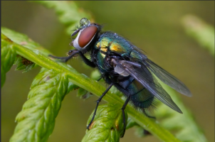

Macro at 5000 ISO
The correct exposure seems to matter more than the ISO level based on my experience. Hard to recover low light if exposed incorrectly, but if exposed correctly seem to recover noise better. I know there are folks here who know better than I on this, but I suspect it has to do with dynamic range and how much can be recovered beyond a certain ISO.
