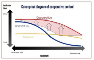

Perhaps a graphic from Canon will help. The blue line is labeled Sensor Shift Only (aka IBIS). See how it drops off along the Focal Length axis toward the Telephoto Side?
If you still cannot grasp the concept that IBIS is less effective at longer focal lengths, perhaps you should just ignore the technological aspects of photography and stick to pressing the shutter button.

That’s interesting. I had no idea that even Canon rated IBIS so much more effective than lens IS on short focal lengths.
AFAIK, the best optical (in-lens) stabilization is 5 stops, and most lenses are rated in the 3-4 stop range (several RF lenses do offer 5 stops). IBIS is rated for 8 stops with the non-stabilized RF 28-70/2.
That seems to be the current cap, as lenses with 5-stops optical combined with IBIS still top out at 8 stops.
