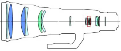

The RF design for the 800/5.6 is quite different from the EF 800/5.6, since the EF version was designed as an 800/5.6 lens whereas the RF is actually a 400/2.8 with a 2x TC included (I drew a magenta box around it).
EF 800/5.6
RF 800/5.6
RF 400/2.8
Thanks for marshalling all the diagrams and it explains your point quite well.
Looking at this I'm just sad they didn't make it so you could switch to 400/2.8 so that built-in TC could drop out like this, maybe allowing also a 1.4x to swing into place (I envision a turret with two TC's and an empty tube that prevents internal reflections).
