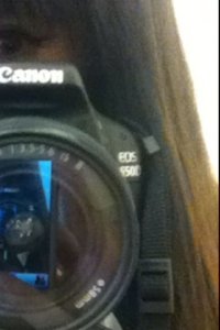

I think it's fake, do canon usually fit UVs to their demo cameras?
Besides, if its asian website why isn't it a rebel or a kiss?
Even if it it is real, what does it tell us, the nomenclature that my goldfish had already worked out?
nentraC said:
If it was shot whit the 650d then the IQ is wors then 600d ;)
I think it was shot with the front-facing camera of an iPhone or something.
I don't know about the UV, but in Asia it's called a xxxD (except in Japan). The Rebel name is only used in the US, and the Kiss name is only used in Japan.
Your right! And besides i think Canon should put instagram on this Baby :D
