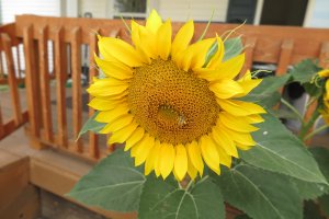

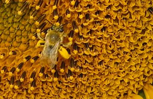

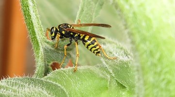

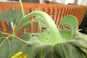

He might rather use something like the G1X which has a close up mode as well as a 24-120 equivalent zoom mode. The Sensor is almost as large as a crop, so it has good IQ. I'm not much younger than your father either, and I'm starting to find it useful as a walk around camera.
Attached are some photos, original and a severe crop. It will focus closer than that, but I did not want to get the hornet angry.
