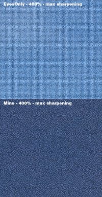

I've not shown any of my shots and I feel I should show you that this issue is not the OP's alone. Here I've got two completely untouched CR2 RAW's, untouched that is except for a reduction to 800 pixels maximum and a jpeg conversion for this site, I've done nothing else to the image.
The pixels seem to be clumping into 64 pixel boxes which creates the odd squared off patterning.

Well, as I have already said, I would return the camera ASAP (and discuss later: Just like saying Shoot first, ask questions later!)
This is not normal at all and it has nothing to do with lens (of course) and memory card (since you mentioned
using the EOS utility to get the picture).
I've definitely seen something like this before.
On my ex-gf's first camera, a 2MP point+shoot thingy, she used it in the rain too much, and from then on all the photos taken in bright sunlight all ended up looking like the one i've attached, way too blue and with the weird grid-lines all over the shop.
Indoors, and with lower-light it was fine though, which made it even weirder. I had a few theories about whether it was a white-balance and/or over-exposure problem, but never managed to fix it. In her case, the solution was to just get a new one, i'd be recommending that you do the same as soon as possible...
