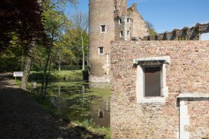

Attached is a frame from a vertical pano, and all the windows have moire. It can be dealt with, but it's there to begin with. Incidentally I also shot the same scene on the M5 and it is the same.
