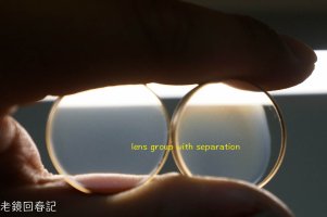

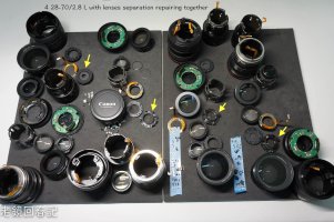

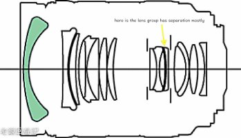

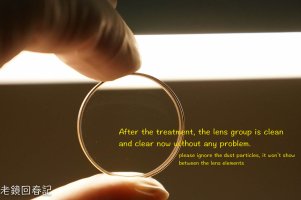

HELLO ALL,
I'm a professional lens repair man in Taiwan.
I'm specialize in repairing various kind of problems happened to lenses, from general CLA to high-end repair such as lens group separation Re-Cementing and damaged coating polishing.
Haze inside the Canon EF 28-70mm f/2.8 L is a typical lens group separation, and this problem can be restored by professional treatment. I've completed over 50 cases in this lens, and all have perfect result.
You may take a look at my blog: http://lens-cla.blogspot.tw/2013/12/canon-ef-28-70mm-f28-l-lens-group.html
It is in my native language, so please refer the posted photos.
I also manage a facebook page in lens CLA, please check: https://www.facebook.com/CLAmanualfocuslens
If you need future information, just contact me from me facebook page or email "[email protected]"
Many thanks, :D
Lin
