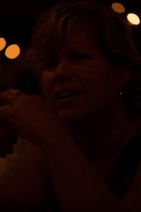

Here is a pretty crappy image shot with a completely outdated tech Canon sensor, that many posters here will adamantly tell you is impossible to do. Now I know it is no award winner, but I also know it would get me out of the sh-t if it was an important moment. I just thought it might be interesting to post an actual photographic example of the appallingly bad Canon tech.
Anybody care to guess how many stops under exposed the image was? It was at a wedding reception and the on camera flash that I was bouncing hadn't recharged in time, so did not fire.
OK, it's pushed fairly hard, hugely downsampled so hard to tell what body it came from.
But, whatever body it did come from exhibits horizontal and vertical banding almost evenly at the conditions of that shot and it's showing up as magenta crosshatch on her neck and some other areas. So it could be any brand of camera at this point.
In a bit of a leap I'd say its from an old digic 2, possibly digic 3 body, maybe a 20D or an early Rebel?
From the histogram, the red and green channels are showing a lot of quantization stretch, so you've pulled this from pretty low down and from likely moderate ISO.
maybe 800 to 1600, depending on the body.
With some of your PS talent you could still make a passable print out of this, ultimate IQ rarely required for portraits.
Exif is scrubbed except for "Ducky" and "Photoshop 3.08" ...
Heh! what kind of surprise are you tryin' t' pull here, bub?
let's see you try that with a digic 4 camera ;)
What, no guess at the number of stops underexposed it is?
Anyway, it was five stops under exposed and all the heavy lifting was easily done in Lightroom. As with most of my illustrative images it was the 1Ds MkIII, along with iso 200, 1/40 sec @ f3.2 with the 100mm Macro IS.
It is funny, to most of us this is clearly a throw away error, but as my interest was peaked and I am doing some printing, I just printed a crop of the worst areas at a full print size of 16" X 24", it is totally usable. I did do a little more processing to it, but nothing major or time consuming, a simple Gaussian blur layer with a mask and a more appropriate curves layer, I also did a magenta HSL adjustment. I know that if the image was important I could do a lot more work to it, and use all kinds of plugins and extras, to get that final few percentage points out of it, but the truth is even with bog stock basic Lightroom you can effectively work images five stops under exposed if absolutely necessary.
Now I, and the Canon combatants here, have never said that Nikon/Sony sensors don't have more DR, we have also (to my recollection) never said we wouldn't like more. However correct use of the camera specifically regarding exposure, and more critically, competent post processing, can mitigate even problem images much more than any of the DR/Sony/Nikon fellowship would have you believe. To say stuff like Canon sensors have "around 10 stops of usable DR", or "8.7 stops", or "I have had real issues with slightly below midtone banding", just displays your complete lack of post processing ability.
Here is my reworked print file with adjustments as stated above, all of this is easily done in Lightroom, you can even do the Gaussian blur layer by using reverse clarity on a brush.
And below that the original without adjustments just exported to jpeg.
P.S. The "Ducky" and "Photoshop 3.08" did not come from me.

privatebydesign said:
Anyway, it was five stops under exposed and..just displays your complete lack of post processing ability.
5... That's pretty good, and you certainly know how to make good use of Photoshop to clean it up.
I'd have no hesitation about pushing files from your 1ds3, a camera with a rep as one of the better low ISO performers made, or even my faithful old 40d. (anyone ever hear me complain about my 40D?)
But there are only 2 bodies I've experienced that are horridly noisy; the 7D, and the 5D2 that I had.
I'd like to see what you can do to try a stripey 7D file under the same conditions, and see how much work you'd have to put in, and what kind of results could be obtained.
Even doing this as a proof does not exempt the fact that some bodies have a lot of FPN and are not suitable for any push-processing in post, certainly not if you have to do a lot of that. Unfortunately for me, I had both of those bandy bodies and stupidly kept them when I should have just returned them. They did have some other redeeming features, and still provided plenty of usable shots, but frustrated the &%^$*$@#! out of me when I had to push low ISO files.
And yes, I'm no Photoshop guru, but neither should I have to be. Far quicker and better for future-proofing to just choose better tools that don't require me to fix such things in post.
Ahhhh, so you often set manual exposure for a flash shot and the flash fails to fire, or for various other reasons you frequently underexpose by 4-5 stops? PBD's shot was clearly a rare exception. If that's not the case for you, I'd suggest the tools aren't the problem, but rather the tool user.
I did nothing in Photoshop that I couldn't do in Lightroom to that file. Indeed the heavy lifting was done in Lightroom, a vastly simpler and cheaper product. But don't forget, that processing was only "needed" because of a flash misfire, not an intrinsic sensor limitation or fault.
The 1Ds MkIII and 5D MkII are a hairs breadth away from each other regarding shadow noise and FPN, maybe half a stop, at absolute most a full stop, that still leaves four stops of lift capability in 5D MkII files. Send me some RAW files, 7D and/or 5D MkII, I don't care, I'll even do another video on what I did to them. The 1Ds MkIII has such a good rep because people who owned them invested the time to maximise their output, we don't flit from camera to camera chasing a magic bullet, there isn't one. In the immortal words of Arno Rafael Minkkinen, "Stay on the f*cking bus." If you want the best for your photography you have to learn it all, starting with exposure! But that includes post processing, yes you do have to learn it. Sure if other cameras have a metric that is much better for a personal style, be that DR, frames per second, size, whatever, then it makes sense to get it, but that does not mean that cameras with slightly less DR, fps, are bigger, etc are not very capable tools in others hands. Yes, the Sony sensor has more DR than the Canon one, but it is not a huge difference and it shouldn't be a serious limiting factor to image making. Yes we all want "more", DR, fps, smaller, lighter better AF etc, but the way you guys harp on about it you make it sound like it is impossible to get a good image with a Canon sensor, when that is very far from the truth.
I understand you struggle with the 7D and 5D MkII, but you need to realise that is because you don't expose with them properly or process them properly the vast majority of the time you have "issues", you can't give the opinions you give without people counterbalancing your opinions with those facts.
