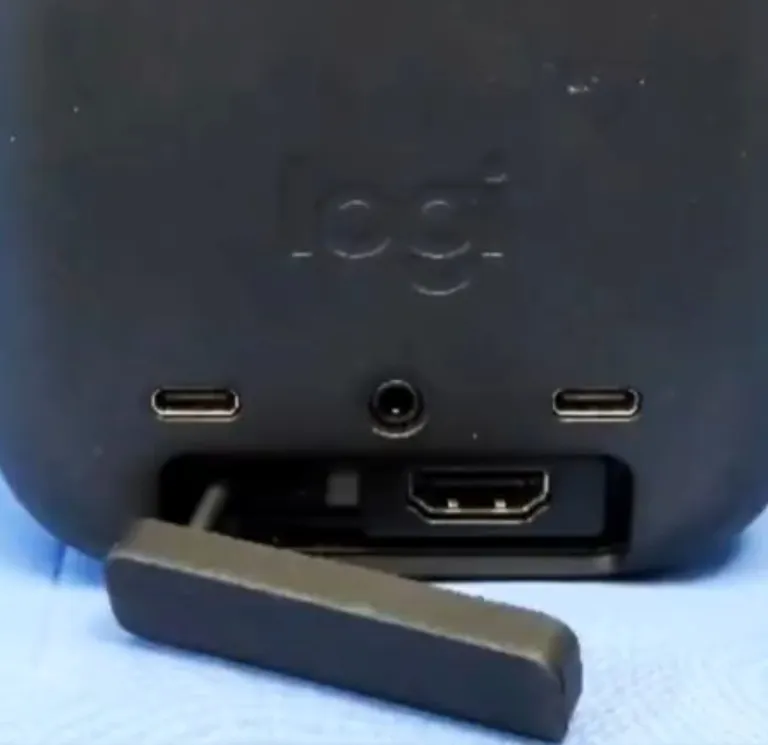

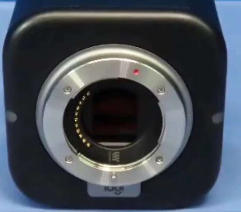

It looks like Logitech is getting into the ILC camera market and will launch a streaming camera (or cameras) under the MEVO name with a micro four thirds lens mount.
Logitech will make the official announcement on March 19, 2024.
Logitech currently has a multicamera streaming system with the MEVO Start cameras and application.
Logitech MEVO Core (Rumored)
  • Interchangeable lens camera
  • Micro Four Thirds System
  • Dual USB-C ports
  • 3.5mm audio interface
  • HDMI Output
  • MicroSD card slot
  • 6400mAh replaceable battery
  • 1/4″ screw
  • Cold Shoe
  • USB-C 20W Power Supply
  • 4K 30fps output
  • Compatible with Mevo Multicum APP
You can see more at mevo.com
Source: asobinet
