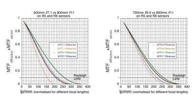

Plots of MTF(diffraction)*MTF(sensor) vs lp/mm for different lenses on R5 and R6
1st Plot
  • The 100-400mm at 400mm f/5.6 is slightly outresolved by the 600mm f/11 on the R5 and more so on the R6.
  • The100-400mm f/5.6 + 1.4xTC at 560mm f/8 outresolves the 600mm f/11 on the R5 and the two lenses are similar on the R6
  • The 100-500mm f/7.1 outresolves the 100-400mm f/5.6 and 600mm f/11 on the R5 and R6
2nd Plot
  • The 800mm f/11 outresolves the 100-500mm f/7.1 on the R5 and R6, but adding the 1.4xTC to the zoom outresolves the 800mm prime.
Adding TCs to the f/11 lenses
  • Using the 1.4x and 2xTCs on the f/11 lens hardly increases the resolution on the R5 and only a little more on the R6. Further, any additional aberration added by the TCs could well render them even worse.
