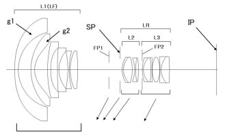

A patent application showing the optical formula for an EF 10mm f/2.8 prime lens has been filed in Japan.
Japan Patent Application 2018-233223:
Focal length: 10.30mm
F number: 2.88
The half angle of view: 64.54°
Image height: 21.64mm
Lens length: 124.58mm
Back focus: 38.00mm
It looks like this patent may have been a part of the EF 11-24mm f/4L USM development.

If anything, the front lens looks even a bit bigger on this one, probably not too different in terms of size or weight, it lets in twice as much as light after all with an even wider field-of-view. With the possibility of using a big rear element and bending light rays differently, a substantial reduction in size can be achieved with the RF mount.
Here comes the usual Rf mantra and regurgitation of recently learned information....done a lot of lens design have you? This patent is for an EF lens not an Rf lens. It is an indication that Canon are sill designing and applying for patents for their EF lens designs. It means that they are still applying R&D budget to the EF format. If Canon feels that they have developed something new...they will protect their "device" by applying for a patent.
It's more than that, it is the patent of the optical formula of the EF 11-24mm f/4L USM.
Example 1 of the patent:
183497
Canon EF 11-24mm f/4L USM:
183496
