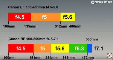

Didn’t Gordon Laing do a video with this lens? It was 5.6 at something like 360mm? I’d imagine it isn’t a great loss in reach with that aperture considering you now get an extra 100mm on the long end. It seems a relatively small compromise to get the RF benefits too.
Here it is again as it is most pertinent.
